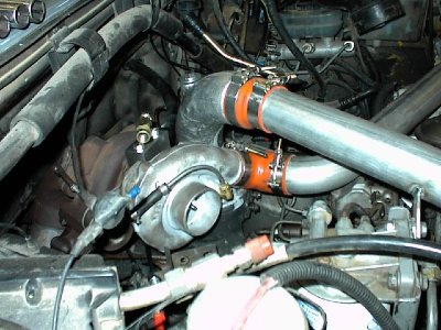

once again...do a search for "intercoolers" and find the thread "let's talk intercoolers" in the IDI section and you will find my install there. here's a couple of pics to get you started.....

Thanks man- Just spent 30 minutes reading that thread. TONS of good info there for sure. I agree with you about the radiator support mounting tabs. I'll probably end up installing some nut-serts in my setup rather than those goofy brackets that ATS supplies.
