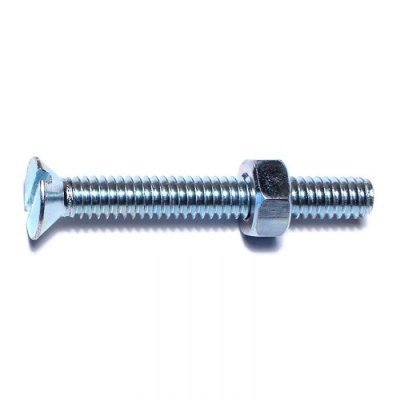

Welding would be ideal, but if you take the rollers off, drill through the skid and through the caster frame, countersink the hole in the caster frame, then you could bolt it onto the skid with some short stove bolts.
There's no room in the bracket for a bolt I don't think. I don't want them rotating either.

I figured it would be too tight for a bolt head. Countersink the hole and use a stove bolt. The head will sit down in the countersink. Two bolts per each to keep them straight.
Welding would definitely be better.

The skid isn't that big really. I wouldn't want to weaken it with holes for bolts. I'm sure I can find somewhere in Amarillo (45 miles on my way south) to have it done. I tried posting on FB groups and here first in case someone was nearby, by chance.
