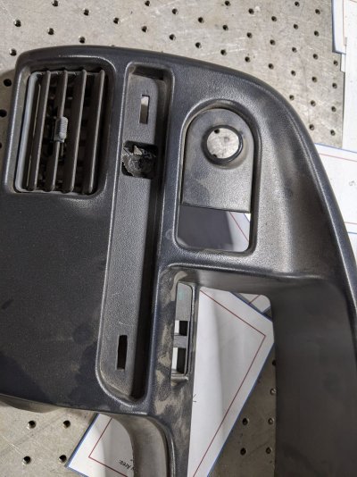

Did they ever make a 96 style dash bezel without the dual fuel tank switch?

I the the F-Superduty only had one tank. There was probably a block off plate to go in place of the switch.

LMC shows the block off in the pictures, but doesn’t show it available or give a part number. I’m not sure if there were short bed F-150’s with single tanks too, that might be another place to look.

The f150s that had one tank have a block off plate. If you go to Amazon or eBay and look at new bezels they come with it usually.

Awesome guys thanks for all the help. I need a new bezel. Has anyone bought one of the aftermarket ones. Any good?

I haven't bought one, Amazon has them around $90, most all under $120. Just look at the reviews is what I can say. Other companies such as Rockauto or CP Addict are expensive ~$200, that's just too expensive for plastic and is overrated in my opinion.

Yep. If you look on the back side there are pins in it. Gas trucks will not run if the harness is not plugged into the plate because the pins inside act as a jumper for the fuel pump circuit. I found this out after a customer had his truck towed to the shop because it wouldn't start after he had the dash apart and forgot to plug the harness back in.

Yeah i was just looking at lmc 239$!! Cpaddict 200!! Geez. Is there that big of a difference? Thanks for the help guys. Ill hunt around for one.
