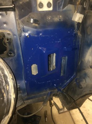

some work accomplished.
super busy these days...
i still need to do more welding, i laid a few down, but its nowhere close to finished.
poped the connectors in to see what it looked like.
bad news, my column i bought does not fit the support.
something is haywire.
ive been summoned out of the shop for the night, so i will see what i did wrong tomorrow.
