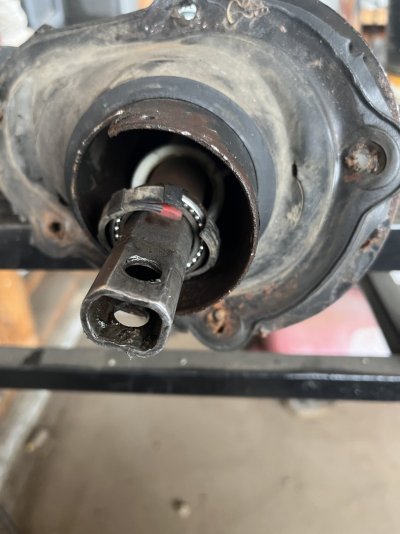

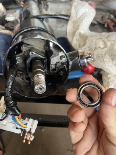

Are these supposed to just slide in and out? If so was this really just the snap ring, bearings do have a little slop anyways so I’ll still be doing that if anyone has a link for the one pictured
Also twisting input and output opposite meaning the u joint appears to be ok

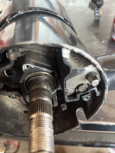

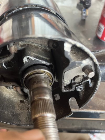

Oh yea this feels like junk

Just got the,
Aluminum lower bearing retainer
1 Upper bearing from bronco graveyard no way in hell I’m taking the tilt apart
And a beautiful 9/16-18 die for the steering wheel nut threads since the 5/8 fine threads is pretty well gone
Wish me luck I guess
