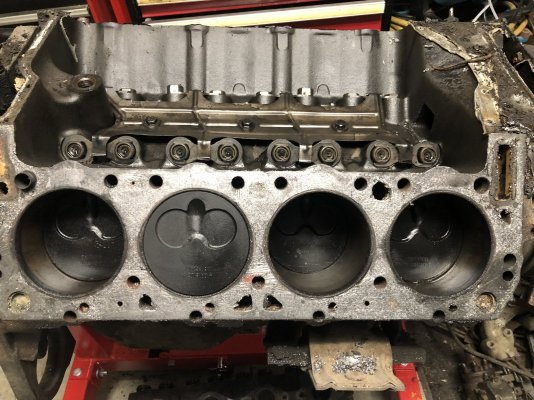

Just to add to what these guys are saying, this is the internals of the factory turbo I am stripping to rebuild, there is carbon, but the valves are pretty clean and seeing as the turbo pistons have a black ceramic coating out to about 4mm from the edge, it is not like it has big chunks of flaky carbon. My daily driver is a 2011 Subaru Outback with a 3.6 and 180K miles, it has way more carbon than this old junkyard diesel motor, but in that case, the PEA additives and direct spray in cleaners make pretty short work of it. I just decarbonized the Subaru motor and pulled the intake to check as I was getting some rough idle issues.

I just realized the original poster is from Finland and probably used to more modern diesels with an EGR valve, without an EGR, very little carbon accumulates in a diesel, if you delete the EGR on more modern diesels, you get the same. Even from this time most diesel cars had EGR but trucks were exempt a lot longer, I have an 85 diesel Mercedes and when I rebuilt the engine, it had a lot of carbon, but it no longer has an EGR. The carbon comes from reburning exhaust. On the engine I am working on now, the only flaky carbon was on rocker arms and the top end of pushrods, and that was likely from leaky exhaust valve seals. In my pic above, I didn't even wipe it down, so considering how black the oil gets, that valley shows how little builds up.
