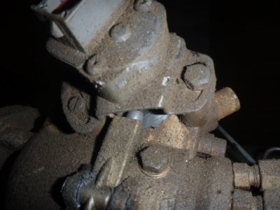

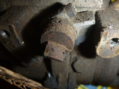

I got a 94 TECA wired in and it shifts through 3 gears. I don't know if overdrive works yet.
I need to locate the small parts for the injection pump to install the TPS. I don't have the bracket or that small round piece that operates the TPS, and do not know where to locate one as they are discontinued..
All the gears have a solid shift as well..
1,442
