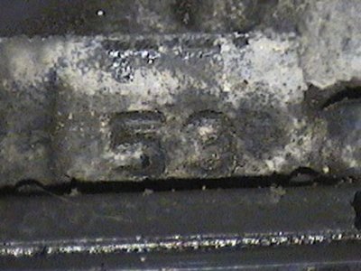

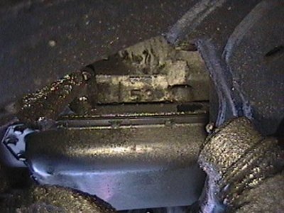

There are many 53's still on the road. Piers will tell you that most of them crack on the passenger's side towards the back in the 5th cylinder area. The number is on the driver's side at the front, just above the oil pan. Here's pics of mine:
