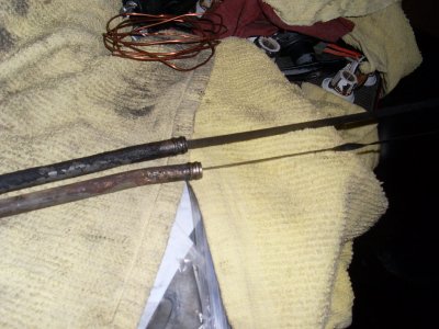

Is the oil dip stick suppose to have an o-ring on the end where it meets the block? Mine doesn't, and it fits loose..

And a said there is an oring at the base of the dipstick tube.

Well there ya have it. Lots of real choices and ways to go. So about the o ring on the dip stick tube... Ta hell with it. Just use some rtv and stick it in and be done the it. Thats what most here do anyway. I know thats what I did and no leaks either...

Don't bother trying to get the oring from the ford dealer, the one they currently have listed is the wrong size and you will go insane trying to force an oversized oring in that won't fit. You can only get it in full gasket sets and possibly from IH, and even then you are going to want to seal it up with some RTV. Might as well just get a glob of RTF and set it in there and clamp down the holding screw up top to hold it in place and you are good to go.
