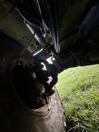

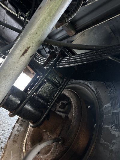

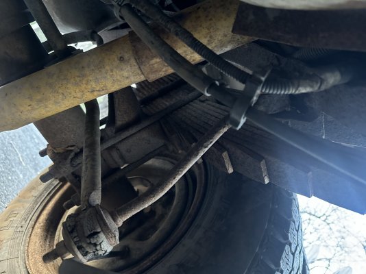

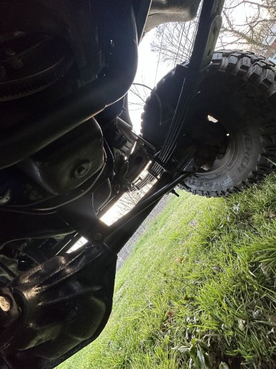

Im going to put the suspension back to stock and refresh the front axle.
Taking it in one large stage and then a smaller consideration.
Stage 1:
The rear leafs look like factory f250 with a block added. I’m going to remove the block and drop it down and put new factory shocks.
For the front I’m going to swap the leafs to factory f350, new factory shocks, new ball joints, pull the carrier and new inner axle seals and ujoints on the shafts. New tie rod ends as needed.
Take my trail rig 37s off and replace with factory size wheel and tires.
Stage 2:
Once I get done with that. Was looking at my f350 and it has front and rear sway bars and steering stabilizer. Now I don’t think I need to touch the rear but I might consider the front sway bar back and steering stabilizer.
At this point, the truck may be reverse squatted when I’m done with stage 1. I see on my dually that both the factory bump stop block and and the spring pack is much larger.

I think the 250 and 350 single use the same main rear spring stack. The difference in 4x4 250 vs 350, would be a 2in vs 4in block. It looks like you have both a 2 and 4 in block, so just run the 4in and you should be fine with stance. Another difference between the 250 and 350, is the 350 gets over loads for added capacity. These are over loads on top of my springs for reference, have yet to put the brackets on the frame for them. Yes this f-super spring stack is massive.
