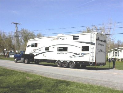

7.3 IDI F450 with ATS Aurora 2000 turbo and ZF5 speed with 5.13 rear gears pulling 38 foot 16000 pounds of camper, cycles, 200 gal of fresh water and 70 gal of gas (camper has generator and fuel station for gas up cycles). Never runs over 1000*F for egt and no intercooler.. The IDI is a work horse set up right...

I pulled my other toy hauler that was 11000 pounds loaded, it had no on board gas tanks, only 80 gal. of fresh water and two cycles. It pulled ok non turbo with out the 80 gal of water on board. But add 80 gal of water and the truck on some hills felt like it was at its limits. Pulling long hills was hell in lower gears, high rpms on the motor with no extra power to up shift to bring rpms down. The turbo made a huge difference..
I love my IDI as long as it can do the job I can spend my money on my other toys and not buy a new truck!
