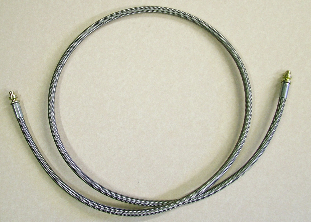

Just looked at my Clutch line, I have the straight end at the
Clutch MC.
I bench bled the Slave. Installed the fitting with Roll Pin.
Unhook the white Strap. Put the Butt end in a container of
Brake Fluid. Then pump the other end slowly till no Bubbles
appear. Connect the trap.
Install the Slave.
I gravity bled the new Clutch line, after you are confident it
is flowing good , connect to the Slave.
Before you push in the Clutch peddle, unhook the Strap ends.
Do not beak the Strap, later on you may need to remove the
Slave, and you will need to use the strap to hold in the Rod.
New Straps are not available, and a bear to install w/o the Strap.
Maybe someone has one of those 3D printers to make them.
