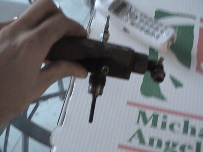

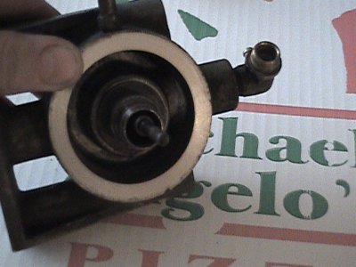

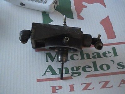

i have been using a glow plug heater. I used it since last winter.and it worked well.;Sweet I also have a fuel heater that works off the coolant.:D
