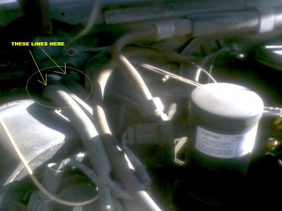

Bought some 5/8" heater hose, brass T's, and hose clamps to wrap my stock fuel filter. Just wanted to make sure I was splicing in to the right hoses before I did anything. These are on the passenger side, one runs from the head to the firewall and I forget where the other runs from, but here's a pic:

Yep them be the ones... the one from the head is the the input line to the heater core (or output line from engine) the other line goes to the water pump. The water pump sucks is an easy way to remember...
Thanks a ton ;Sweet Still quite the newb on this WVO stuff and the truck in general. Will work on making up a wrap tonight :thumbsup:

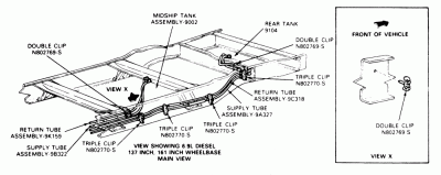

Thanks, now I just gotta get in the manual and under the truck and see where the switching valve is. Found a pic on Autozone.com showing the line routing and it doesn't so the valve so it must be forward of that.
What would be a good plate amount for a cold climate? If I can run WVO for 3 seasons a year I'd be happy. I'm thinking stock fuel filter coolant wrapped, WVO fuel filter heated (12V or coolant), HIH lines, FPHE, and a 12v stick-on pad heater for the tank. I'm trying to avoid having to drop the tank and mess with it.

It's tucked INSIDE the driver's side frame rail about as forward as where the front tank is.
Thanks, crawled around while changing my transmission fluid last night and found it.
