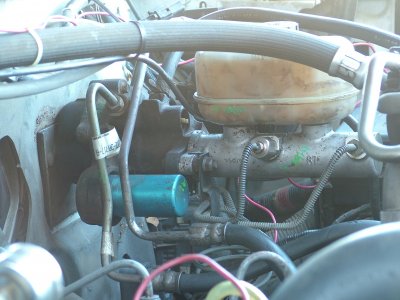

Ok, I'm being told, if I purchase a hbooster it will mount where my booster currently is. I've got to confirm that. What you want for the pedal? I don't think I can send PM yet.
Thx.
Yes, the hydroboost will mount will mount in place of the current unit. I'll attach a picture of mine, on a '92 F-350 cclb dually.

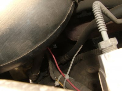

Thx for the pic. If you will and gave time, can you provide a pic of the routing of the 2 hoses? It appears the return line is in pic. Thx.

The routing of the high pressure hoses? It's a bit dark in there, and my camera had a hard time. I'll post two pictures. One will show the start area up top. In that picture notice the hose which takes a nosedive, near the hard line with the spring-like thing wound around it. You can see that same small hard line in the second picture, just for orientation. The hose which took the nodedive seems to attach to the rear of the reservoir, while the second hose attaches to the side. Keep in mind that you must have the hydroboost reservoir for this.
I have a vague recollection, also, that the fitting at the power steering end are different. That being the case, you cannot put the in the wrong fittings. I believe that to be true, but I could not swear absolutely.
