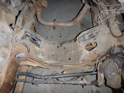

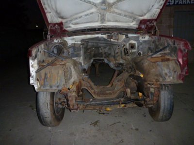

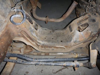

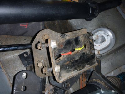

1,442
confrimation.

13,438
4,189
with a large enough hammer.....anything will fit.
:D
that hammer needs to be used on the owner of Spectrum Auto in Antioch California
may as well go into the hall of shame.... just in case that someone local looks.
682
Great pics Calvin. I have seen this pic on my rig 6 times so far. Its really interesting to me watching the motor mount bolts dropping down into those slots. They seem to be not possible but they just fit perfectly. Then the horrible reaching in to tighten the nuts that are the interference fit threads. I recall something like a 17 or 18 mm nut.
