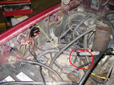

What brand of glow plugs are they? If not Beru, I would replace all 8.
It appears that the GPR is working correctly. Check the feed wires to the GPR at the connector. I think it´s on the passenger side for your truck. It is not unusual for them to get corroded after years of service. Sometimes it gets so bad it melts the connector! You may want to by-pass the connector entirely. I soldered the yellow wires together by-passing the connector.
attachment.php
How do you guys have such clean wiring? My truck is a rats nest. -cuss
This one had the 3G alternator upgrade. Note the 120 amp circuit breaker by the starter relay. Also the absence of the external voltage regulator and wiring. :)
