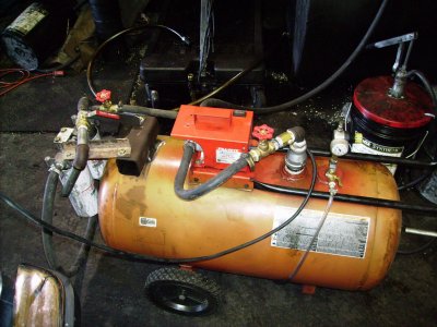

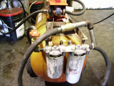

I have to give "Big Rig Tech" credit for the initial idea.
same thing i just took his idea and put it to my own and the free stuff i had laying around thanks bigrigtech
i use our 300 gal oil tank for storage pump it out of there with the pump monted on top close the valve so i dont pressurize the pump then add 20psi regulated and it pushes the oil throught my filters and then into my tank pretty simple set up but the next thing i got to do is add a fuel heater to my truck for winter
