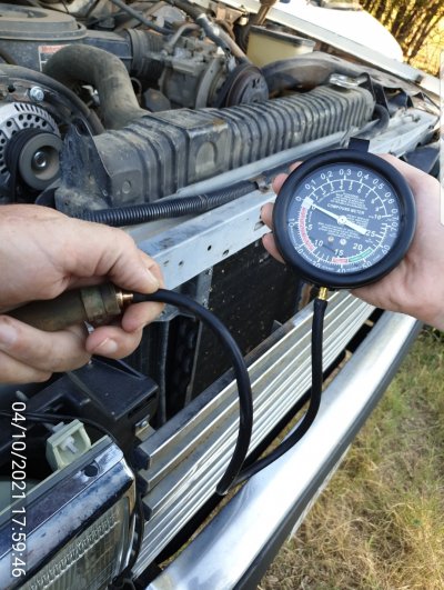

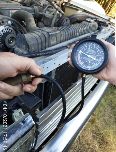

OK, just checked. I followed the large hose to a diverter on firewall. Followed small hose to a diaphragm with 2 wires on right wheel well, started engine, then disconnected small hose from diaphragm and plugged it on to gauge, nothing. So I looked in the gauge kit and seen larger brass adapter. I reconnected small hose to fender well diaphragm, then disconnected large hose from multi vacuum connection, inserted brass adapter, then hose to gauge. With engine still running.

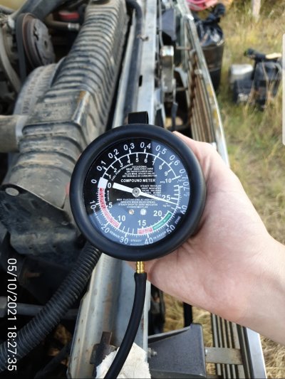

Update: AutoZone called a little past 10:00. Drove the 35 miles. They used a 3-prong puller and bent my pulley but didn't remove it. We walked to Ford dealer and they stated it takes a special tool to remove and install the pulley. So they did it and charged me $20. Installed new vacuum pump, started engine and plugged in vacuum tester, it went way past the green. Looked at pulley and it could win the twerking class! So, mgr came out and looked, they ordered a new pulley and it'll be in Thursday. I told him its $20 to R&R the pulley, he said OK. Don't need to push the brake pedal! Yes, we looked like bobbleheads! Question: what else does the vacuum pump run?

Thanks guys! Should I post pic of vacuum gauge reading after new pump?
