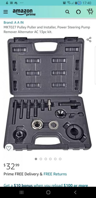

OK, ordered this one from Amazon, identical kits were a lot more money, others had less tools. I will buy the power steering pump from AutoZone, in stock with lifetime warranty. So I'll be using the new tool kit, will post here if it worked. Also need to order pressure line, figure might as well as they are original too.

That looks very close to the $20 HFT one, which only has one less piece.
Ouch, well the closest HF is about an hour drive, my luck the adapter needed will be the one HF didn't add to it, Lol
I can still cancel order I guess, but if I buy the HF and not correct adapter, it'll be another 2 hour drive. I know, tuff decision.

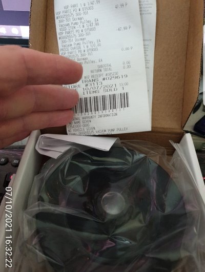

Drove to AutoZone in the next city and picked up the vacuum pump pulley. It cost $47.99, that's almost as much for the vacuum pump!
Then went to O'Reilly and bought the power steering pump w/resovoir for $53.99. I'll check RockAuto for pressure hoses and return, maybe less expensive.
That's why it's best to buy the proper tool to begin with, it costs less than the pulley. Lisle 39000 is $45 and is confirmed to work with (at least v-belt) IDIs.

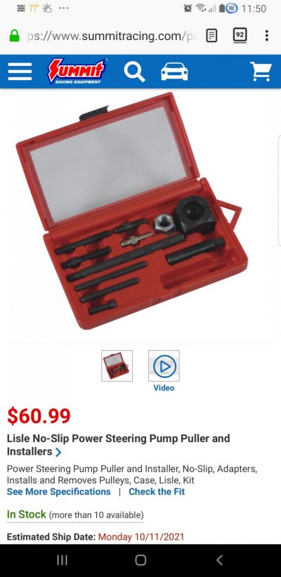

Here is puller at Summit. I paid $32 on Amazon for a larger kit. Yes, correct tool for the job. I hope AutoZone learned something.
They learned a pulley gets sold if they bend one.
That Summit kit looks identical to Lisle/Napa 39000 except for the case color. (Edit: oh it even says it's Lisle)

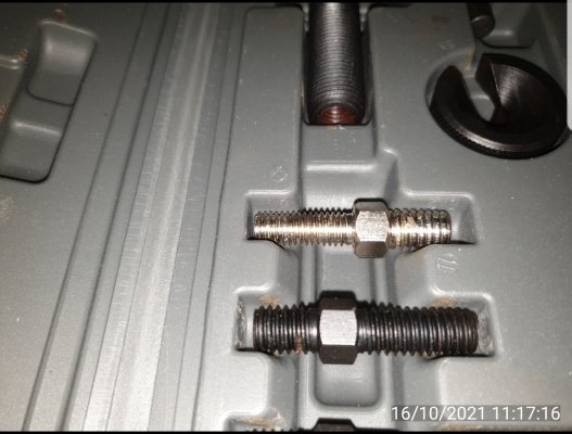

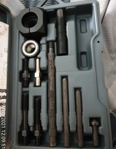

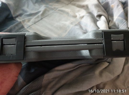

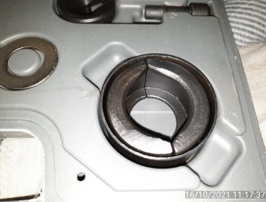

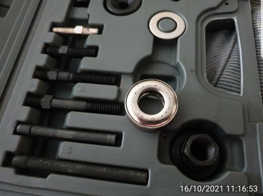

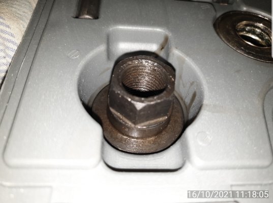

Received larger kit, total junk. Tools look to be casted, many pits in between threads. Shipping it back today, ordered the Lisle 39000 instead.

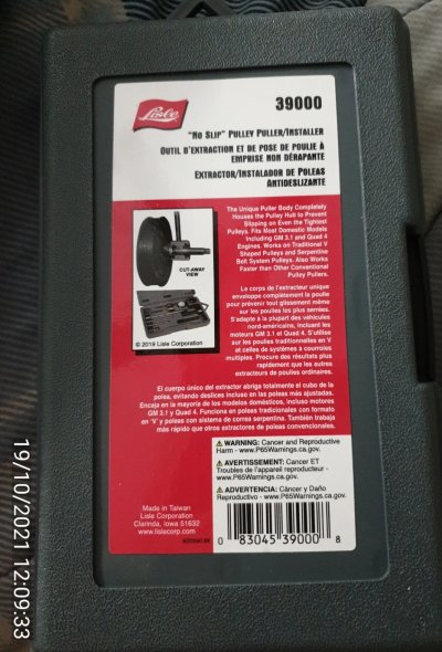

Received the Lisle 39000 kit last night. Definitely made better and only one tool needed to remove/install pulley. It was about $8 more than the Chinese made kit.
