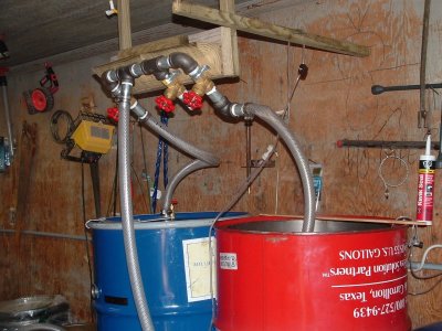

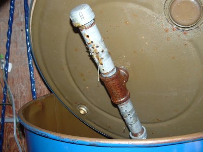

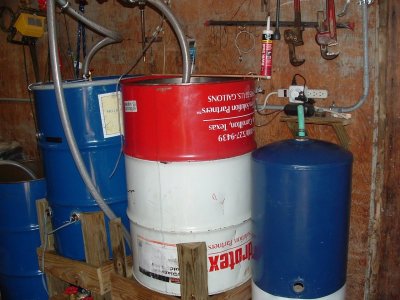

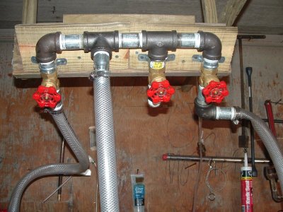

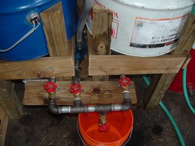

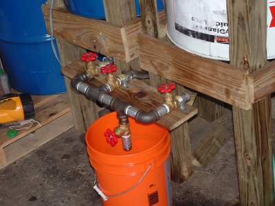

Here are pics of my setup.... This is an older set of pictures, but the only thing I've done different is replace the red and white metal barrel with the clear poly barrel with concrete..

Thats a pretty clean looking setup you have going there. Alot cleaner than some of the DIY bio processors I've seen on the internet. If you dont mind, and if I do get into making bio, I think I just might go and copy your setup.......there's no copywrite on it is there :D LOL ;Sweet.

No copyright info here....copy away!
As I said earlier, try to limit the amount of that flex hose you put in there....after a year or two, you have to replace it all. As it ages, it "sweats" oil, so it becomes nasty and sticky. If I were doing it again, I'd run just one hose from the pump up to the upper manifold and that's it. I like having that part clear to use as a sight gauge.

So if I get this straight, sorry there will be more questions to come I'm sure, but the Blue 55 gallon drum is the "proccessor", and its where the oil and methoxide come together and get all warmed up (with heating element), and mixed together (with the aid of an electric pump). Then after that is all done, it is moved over into the wash tank, which in those pictures is the red and white barrel, but your now using some poly barrel with concrete bottom to make it drain better. The wash tank is used to add water, which then attaches to all the crap you dont need, and then after settling gets seperated, this is done several times to get most all of the stuff you dont need out. Then you let is settle and get the glycerin out, and your left with your biodiesel .Then after that you dry it by turning on the air bubbler thing which is some sort of aqaurium air pump. And then you should be all good to go, correct LOL ? Its a little condensed, but I think I'm getting it.
So whats the little blue barrel in the picture? Is that to mix up the methoxide stuff?

Just about got it..
Yes, the oil is heated in the processor, and then the methoxide added. I have a 10 gallon metal milk "jug" that I use to mix my methoxide. Not pictured. You could use two carboys (that's what I'd do -- makes mixing easier).
You let it settle in the processor, drain glycerin there before moving to the wash tank. If you get glycerin in the wash tank, it makes washing more difficult. Then, proceed with the wash as indicated. Each time I add water, I bubble wash, settle, drain, and begin again (if needed). After the drained water is clear, then proceed to dry.
The blue barrel on the right is actually a pressure tank I pulled out of a lake. I was going to try to make that into a processor, but it's a bit to small for my liking. I'm now going to use that to filter my WVO....
