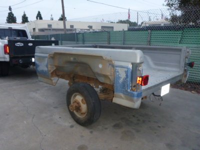

one more thing, if you haven't been told already, you have a converted dually pickup. if you intend to haul heavy, you are best off in finding a pickup dually rear axle. what you have in the pic is a SRW rear axle. there is no place to center the rims and hence the need for the centramatics.
the below pic is the best I can find to illustrate the point. notice how much further the hub section sticks out? the rim acutally centers on the non-flued portion of the hub and sometimes they will weld themselves via corrosion. with the correct axle plus the centramatics, you'd swear you're riding in a big Lincoln Continental.

every indication tells me you are a SRW to a DRW conversion. the doghouses look aftermarket due to the placement of the running lights.
when you look into the inside of the truck bed/doghouse area, is there a cavern as big as what you see in the pic I posted?
