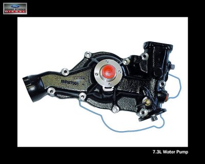

daryl do you know anyone that has put the IH filter pump on a superduty? that is what i'm planning on doing... i have found quite a few that have put them on the OBS trucks but not a super duty...
the 00-03 model IH water pumps with the filter don't have the *** that needs to be ground.. down but the water outlet doesn't turn down like the older model pump does... here is a image by dale@strokeshop from my thread on SDD.com
