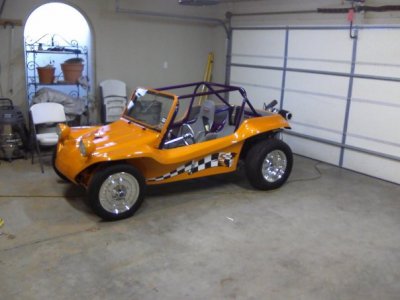

Something for typ4 after reading his sig. Its a 2384cc engine with turbo in a street legal buggy, that my dad now owns and my cousin built
