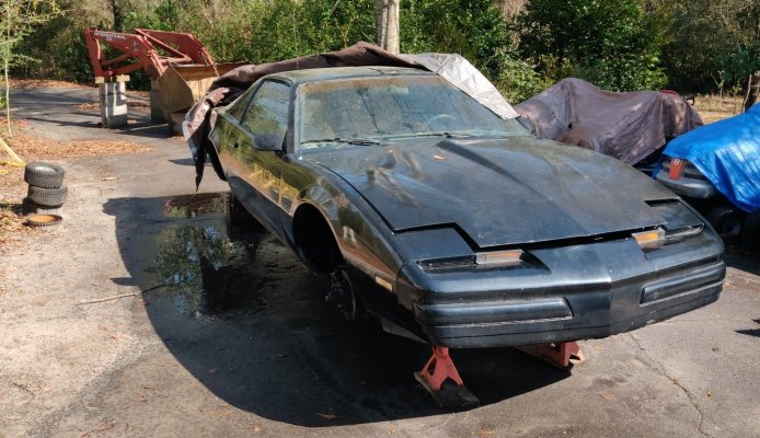

Seeing vehicles all on blocks makes me think of "Back to the Future" and flying cars. It's like the "Flying Walrus"!!!
