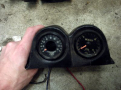

I have a complete non-wastegated banks kit (gauges too). The only issue is when my brother was removing it he broke one downpipe bolt off in the exhaust side of the trubo. He stopped there and did not remove any of the other ones. The up pipe is for a C6 tranny. I can get photos if you like.

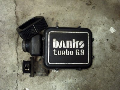

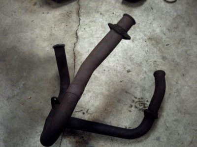

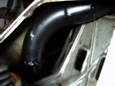

Here are some photos of the turbo. I was unable to locate the CDR blockoff plate and the oil fill tube but I will look more this weekend. I have them I just need to dig a little deeper. I have also attached some photos of my ZF5 install which resulted in the modification of my turbo uppipe. I have the exact same turbo on my truck but when I converted from my C6 to the ZF5 the uppipe would not clear the bellhousing so I had to build a new one. Hopefully from the photos you can see what I did. I also had to install a 2 inch body lift to provide the needed clearance between the body and the top of the ZF5 bellhousing. All of the photos are shown with the body lift installed. I used 2" pipe to make my new uppipe. I have heard that Banks made two different types of Y-pipes and turbo pedistal's for these turbos, one for the autos and one for the manuals. This one is for an auto. I also had to grind the ribs off the ZF5 bellhousing on the downpipe side allow the DP to bolt up to the turbo. I hope this helps. If you are still interested I will let you know when I locate the missing items.

Sounds like you have saggy cab mounts Squeaky, though the pipes are a tight fit, and nothing wrong with a 2" lift anyway. I think that the Banks pipe is transmission specific, I thought it was the downpipe not the up pipes though. Building new up pipes is going to be some work. Banks might still have these but they would be some money. Downpipe is probably not too bad to fab a different one if you have a template for what you want.

Contrary to common belief, the Banks system pedestals are exactly the same between automatic and manual transmissions. The only difference is the way the crossover piping runs for each kit as the downpipes are the same. I should know as I have owned both versions.
If you can find someone to fabricate a set of up pipes for you, be prepared for the final bill unless you can get a buddy to do it for ya LOL. When I had mine done for my hypermax turbo kit, I did ALL the prep work and clearance but still ended up paying almost $700. Note that bill included the entire exhaust system and I can't complain as the shop did a hell of a job on it. ;Sweet

i had the same kit and it was missing the block off plate so i made one and reused the grommet off my ccv to seal it up with i made it out of 1/4 " plate
Banks does have these - I just got one. The up pipes are tranny specific, cost an arm and a leg (~$400), and they "engineer" the clearance on the C6 model by sticking the neck right below the pedestal in a bench vise and clamping the diameter down by about a third. It really looks like it chokes flow badly, and I'm thinking of sending mine back. I don't really see the clearance issue, as the tab on my firewall isn't even notched. It's strange, because the workmanship is otherwise pretty clean. I have an email into them to see if that's the only difference between that and other up pipes.
