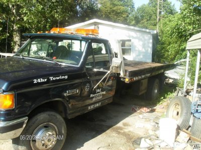

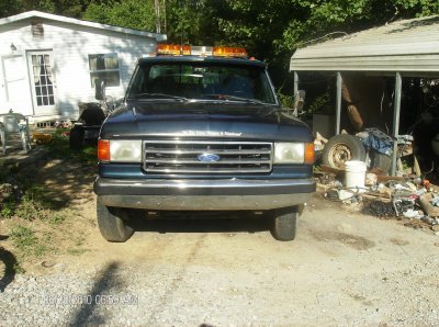

I am looking for a turbo kit for my 1991 ford 7.3 IDI non turbo motor
if anyone has one for sale please drop me a line. I don't have a lot of money to spend but i know they high please let me know
My truck is lead sled the weight before we load it is 11,950 it does ok but needs more power...

The best setup for you is the ATS wastegated turbo. With the gearing in these trucks, we have to really spin them to get power. Do you still have the wheelift on the back? Chevron overbuilt theirs and you take a weight penalty for it.
Here's a pic of mime.....

ya its got the wheel lift i have owned this truck 2 times now its been a good truck and still is but looking for more power i have read alot of info that by the way is very helpful on these forms and i think you are right about that turbo kit from ats
