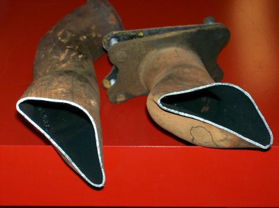

Since I bought my truck, I've been kinda concerned about the 'kinks' and constrictions in the stock dp. While putting the truck up on jackstands, I had a chance to take a close look at the pipe. dang!! That sucker looks crushed in a couple of places! I ordered a 3" mandrel bent dp from JetCo, and pulled the old one off. Wasn't very hard - four bolts hold it to the exhaust pipe, so I soaked them in Deep Creep for a couple of days. All four came off with a ratchet. The V-clamp that holds the pipe to the turbo outlet was easy, as well. The new dp arrived, and I decided to take some pics for comparison.

I think it IS/was crushed...
I just finished doing head gaskets on a friends, and that one was perfectly round compared to yours
See, that's kinda bothered me ever since I first saw it. There didn't seem to be any reason for it to be crimped like that. Plenty of clearance - the new oversize dp fits just fine - and I don't see how you could mechanically do that to a piece of tubing without serious damage showing up somewhere else. Very wierd... :dunno
LOL L O L , my thought exactly Bear.
Just bought a 4" Stainless straight-through with 3" DP all mandrel bent exhaust system. Installed easily in a few hours - what took me the longest was getting the old exhaust off. :)
When I got the OE-dp off, I thought "*** !!"... at first I really thought mine had been broken too, looking so beat up *gg* ;p
