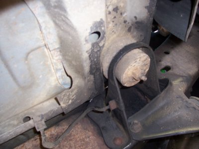

I got energetic today and crawled under and took a couple of pictures. Side not, there was still some rubber on the radiator support mounts, but I couldn't see it till I cleaned the rust off ( I didn't know rubber could rust....must be some of that special ford rubber :dunno the rubber on the bottom was all split out and crumbly, but hard to see in the picture.
Here's the results:
It doesn't look pretty.
------------Robert

I'm going to try this picture thing one more time:
------Robert

Dsl_Dog_Treat
Jan 13, 2005
7,191
160
Decatur,MI
Looks to be time for a fresh set of cab bushings.
The energy suspension bushings are a good choice but I have noticed a bit more road vibration with them as they are stiffer than the factory ones. THe hockey pucks did soften it back up a bit.;Sweet
I found the hockey pucks at a sports outlet store. When I dropped a dozen of em up on the counter, the clerk asked me if they were for a body lift.:eek:
Dang she was good.:hail
I politely said yep and gave her my 12 bucks.:D
