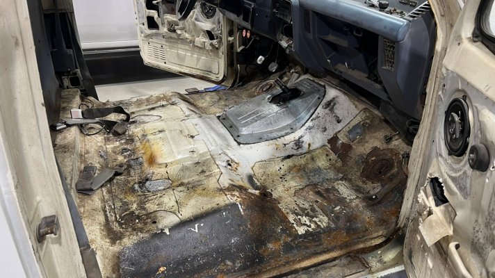

Old floor matt:
Also got rid of the old sound/heat insulation. That left me with this:
Rear door corners are pretty rotted:
I'm scared to take a needle scaler to those areas thinking it will more or less remove everything. Can I just use some rust encapsulator instead to keep it from getting worse?
