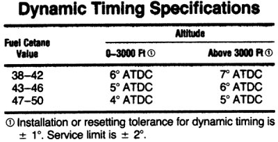

Okay, So on Friday I am going to take my '88 E250 in to have the timing checked/adjusted. I found a shop locally that was recommended by a forum member. I spoke to the person who would be doing the timing. He used to own an IDI and will be using a Snap On Luminousity probe that screws into the #1 GP hole. It then attaches to his timing light....kind of like the Ferret meter. My question is:
What should the timing be set at with this type of a probe?
I know that when using a pulse timing meter (like the Ferret), you set it to 8.5* BTDC.
With the Luminousity probe that is detecting the actual detonation I have found mixed info. I found anywhere from .5-1* ATDC to about 5* ATDC. Does anyone have experience with this type of meter that can shed some light on the subject. The shop seems to know what they are doing, but I always like to be educated on the subject before I walk through the door. Thanks

7 - 5 DEGREES ATDC (PLUS OR MINUS 1) @ 1400 RPM
1.yes,this is how the 6.9l was originally timed.with a timing meter that read the rpm of the engine via a crank sensor probe,as you called it a "magnetic pickup" and senses the actual combustion chamber event time via a small glow plug with a glass window,known as a luminosity probe.
this method if done correctly is always at operating temps,all accessory loads off,engine at 1400 rpm,and always only somewhere between 7 ATDC through 5 ATDC depending on elevation and fuel cetane.
as you can see in the chart there,1 degree either way is still whiten limits,but one degree only from your elevation and cetane rating ok.
whenever you see someone post ATDC numbers that contradict this chart for the 6.9l and 7.3l,they are basing their numbers on noting at all that im aware of besides their guesses,and i feel they simply haven't educated themselves in the method properly.
use extreme caution if you decide to listen to others who post ATDC numbers outside this chart.particularity lower numbers.severe engine damage can result! fair warning!

682
I have not used the luminosity probe type timing method because I don'y have the cetane hydrometer needed for that. Plus I don't want to remove a glow plug and risk any extra work doing so. Is the lumi probe type timing as good or better than the clampon type timing??? I really don't see it being better or worse.. Just a little more work to do. Now if you are to get the cetane reading and time the engine... Then get a tank of lower cetane reading fuel will the timing change... Possibily. So how will the timing change if you use the clampon probe timing method and the cetane changes... Not one bit because your using the pulse method of timing and its not dependant on cetane reading at all. At one time the lumi timing was all we had but things change.. I really am not able to positivey state what the lumi timing should be set at but some of the postings here are very correct. The 1400 rpm is right on a warmed up engine. The cetane reading is a must have too. And finally the degrees of timing doing it by the lumi method is defiently in the after top dead center reading of timing... Ot atdc.... Not the before top dead center or btdc...
