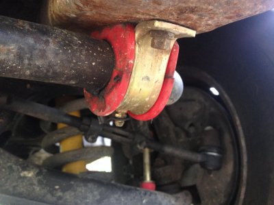

So you just want the Rubber not the metal tab?
Looking at my 86 it appears there the same style that's on my Suburban.
these are energy suspension bushings.
