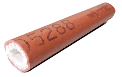

Get some of this, 1 inch size will protect the throttle and cruise cable.
92 up throttle cables wont work in early trucks, throw is wrong to get proper throttle action.

Ditto on above, if going by the exhaust, turbo, or on top of the shunt for the glow plug relay try this stuff. But don’t lay it on any of these.
