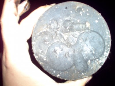

here is a rod I think it's possibly bent and also possibly bad piston that touched a valve

I believe Joe drove his truck home from South Carolina after the "kiss". Don't think his rod would look THAT bad.
