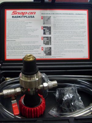

I can feel your pain. Mine was the same way. I bought the very first one that was made by Mityvac for 350 dollars years ago. Bought the junior kit from snapon to replace the mityvac after it wore out. Then bought the deluxe kit because I got tired of how the junior kit sealed to the neck.
