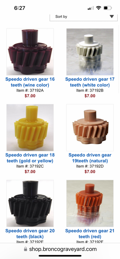

In my experience it's a three mph change between gears, mine was 10 mph I just kept buying them until I got it right, I should have just bought the whole set.
I ended up buying a no-name brand eBay kit years ago for my larger tires and 3.55 gears. I got the kit because I wasn't sure which gear I needed for sure and it was only a little more than the single gears anyway. I'm glad I did!

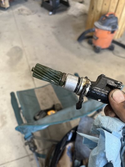

I need to change gears to fix the speedo reading, too. In the past, they were color coded (for number of teeth), do not know if they are anymore.
They still are, but also best to count teeth as whatever you buy is usually aftermarket now. Maybe entirely.
