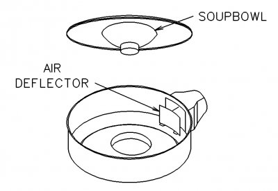

You might have to host the pics elsewhere (photobucket) I hope the pics do a good job explaining this because I have no idea just going off of your few sentences.
Here, it's not to scale, but you get the idea...
