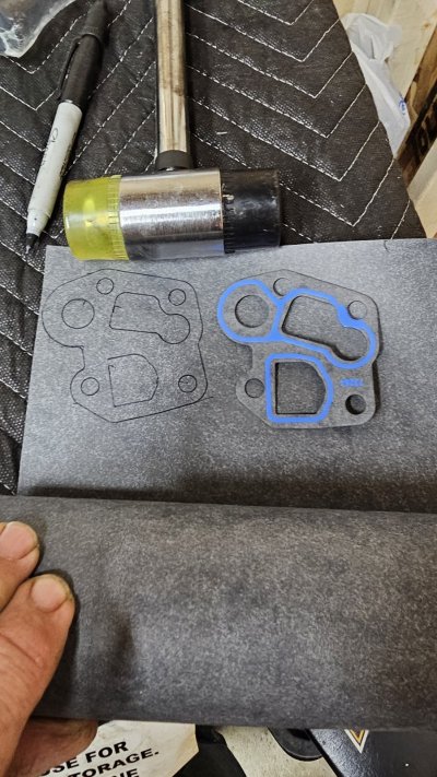

So I bought this oil cooler a little while ago that I told you all about. I was nervous about installing it on blind faith so I built this rig. It is 1/8 × 3 inch plate. (I would us 1/4 if I did it again).
Then I used some fel-pro gasket material and traced some gasket to use on this tester
Worked out the hole placement and taped in a schader valve
then also thread in a pressure guage.
this is the final product. I am only pressuring the coolant side but any loss of pressure to a leaky oil side would have presented itself by the guage. Looking good so far.

I was a little leary of putting that much pressure on it since I really did know what it's limits were I ended up at 60 psi and it held that for an hour so hopefully all good. I soaped it up good and no bubbles so on the motor it goes
That should be plenty. Engine coolant psi is supposed to be 13 psi I think, maybe 14 I don’t remember for sure. 7 psi rad caps exist too, so 60 psi on the coolant side should be more than the oil side will ever really have, these engines have pretty low oil pressure in the greater scheme of things…
4,209
4,793
Also take into consideration what the oil pressure when cold and at rated speed is, its pretty high, thats why the test pressure is high.
60psi with no leaks for an hour I'm willing to bet it is fine too.
