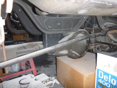

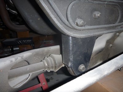

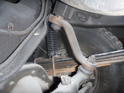

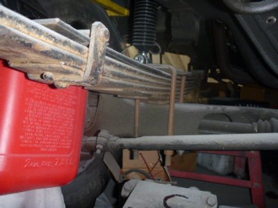

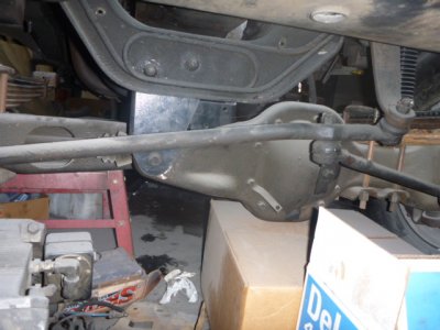

this is what a 4in lift kit with dropped pitman arm looks like installed. biggest thing is the tie rods are no longer at the sides of the socket and is centered in the socket again. there is also a 2in body lift on the truck. yes, it sucks working on this truck inside the engine compartment.
