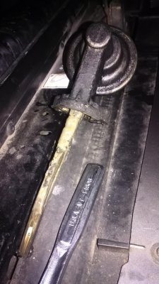

Took my lift pump out yesterday and found what appears to be sludge on the arm. The previous owner had the truck looked at a local diesel shop and said on the invoice sheet that it had bio-diesel ran through it. Could that be causing it to appear on the lift pump arm? How could i clean the tanks to get rid of it? Thanks.

Looks like what coolant or moisture does to oil... have you drained the oil to see if there is any more of that goo? There's a slim chance it's a grease overused on lift pump install.
Bio itself is a good solvent and doesn't typically gel up like that on it's own, but it most definitely should NOT be there on the arm.

how long has it been sitting?
that looks like condensation to me.
in the hotrod boating world, we have to put up with this alot.
i would change oil and check for milkshake.
every season, i run a qt of ATF in the oil for a day, (1-2 hours of normal boating opration)
change again, and watch all that crap bleed out of the drain plug

+1 on ATF flush. I used to get the same crap from my SRT4 in the ccv catch can.
There is definitely something else, possibly quite detrimental, going on in your oil.

Its been sitting for a couple of months. I'm going to drain the oil and install the new pump today after work. I have a can of diesel kleen in the truck also. Can you get the ATF from a local auto parts store? I really hope it's nothing bad

Any diesel rated oil will have more detergent in it than ATF so adding ATF to the oil is a gamble. If you want to actually clean things out get some type of oil flush.
Also penzoil is one of the best oils on the market like oldbull mentioned. No sludge issues that's a myth.
