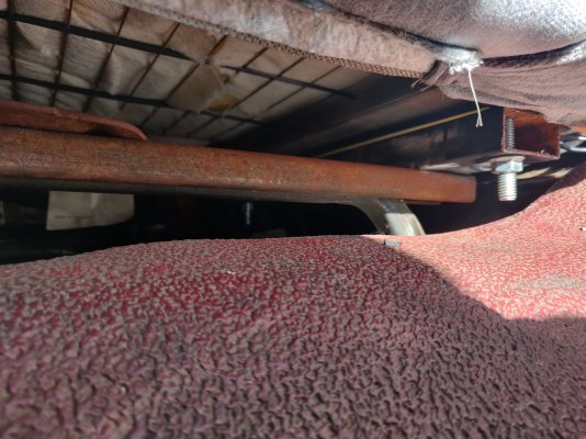

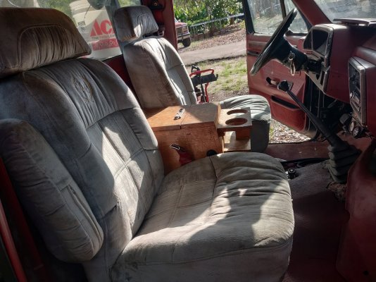

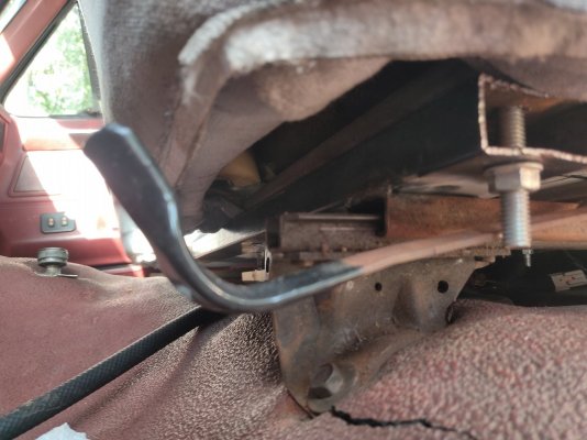

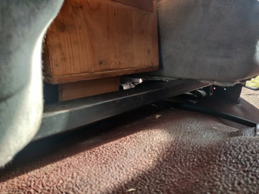

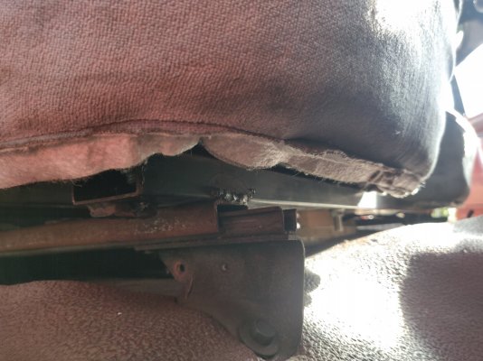

You'll have to drill a couple holes but they'll set right in there. I'll take a picture in a little while and put it on here, but I pulled the bench seat out of my '90 single cab tow truck and used the floor brackets, made a frame and bolted captain seats I kept out of a conversion van. My center console is a homemade rig that is screwed to the floor. My seats sit about an inch higher than I like but I'll get over it.
3,294
3,747
It's impossible to get really good pictures of this, but a couple nice seats out of a conversion van and a piece of steel might be easier to get than bronco or F150 seats. The center console is mounted in such a way that my seat frame moves under it and it stays stationary, not that it matters I'm 6'3" so the seats will stay all the way back.
