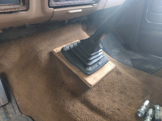

Hey, I was staring at my t19 collection and a thought struck me about scoring and installing a zf5. The zf5 is like way taller than the t19, same length, and the mount sits right in the cross member, but it's taller. So I had to "modify" the transmission cover plate that bolts on the floor board. I know you're going from an e4od, but maybe one of you guys who know can say wether or not the plate is tall enough for an e4od to zf5 conversion.

The easiest thing to do is to get the right plate and swap it over. There isn't a place for the shifter to stick through on a plate for a C6/E4OD. I took the four speed out of my Blue Truck and put in the ZF5. When I did it, I was still planning to keep the Bronco (even though I had stolen the engine, trans, and transfer case out of it) so I didn't swap the plates. I took the shifter off of the top of the ZF5 before I installed it, which I like to do anyway since it makes it easier to remove and/or install without it on the transmission. It was close, but it did go in and the transmission doesn't hit the plate. I can't fasten the shifter boot down to the floor since it's the wrong plate, but that doesn't bother me too much.
Hey IDIbronco, I've noticed in a couple of threads that you mention that your shift boot doesn't reach the floor board, so I wanted to share a picture of what I did. Now it might not be obvious, because I tried to make it look as factory as possible but there it is. Totally custom.....
