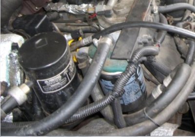

Brad,you understand the type of coolant filter your using simply dumps the SCA's into the coolant and then they are gone from the filter correct? it's just a simple way for you to add sca's by replacing filters when required,according to the test strips,while also filtering out junk in the system.
you need to replenish the system regularly with liquid or new filters.
so if you flush the system right now and keep the old filter on there,you would just be using an old,now blank filter free of any sca's.
if you want to run a more advanced filtering/sca system,here is what i do;
pre charged fleetcharge coolant.
penray need release filter - simply swap it out every 18 months.part# NF2088 screws onto the napa #4019 filter head.
now you have a filter that only releases sca's from the filter when it's needed.it does the job for you.
no more need for test strips, or flushes (according to fleetcharge's FAQ section.)
check it out;
http://www.penray.com/images/NeedReleaseRiseAboveSellSheet.pdf
http://www.fleetchargeantifreeze.com/faq.htm

That is a terrific filter and great way to nix the need for strips, however there are more than one of these IDI's locally running about and to be honest I doubt every one is going to add a filter.
As one of if not thee goto guy locally for info and such on the rigs I field a ton of questions and most want to ensure their coolant is ip to ***** however when I have sjown and suggested a filter they nod agree and say well....I dont k ow...why do I need that my ____ new truck doesnt even have on
So back to strips.....I need strips....will see what can find.
