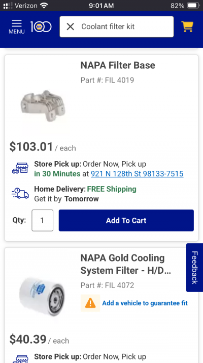

I just got this:
Baldwin Filter Base
Part #: CFB5000|Brand: BALDWIN|MPN #: CFB
Need to sort out how / were the best mount location is on the 86 F350, get some tees, ball valves, and a filter. But parts are stacking up. Thanks for the write up and the pictures. I'm in the middle of distilled water flush to go from green to pink pre charged coolant. Gonna do one more then change over and hopefully have everything I need for the filter. I thought it was reasonable protection and maintenance benifit (probably won't check for SCAs - just put a charged filter in every other filter change) for the price.
