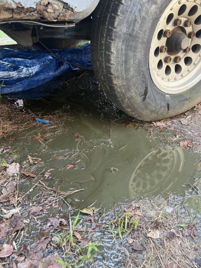

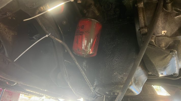

But, now there’s this to figure out. All the “oil” that was in the truck is now on the ground.
At first it looked like it was leaking from the oil filter, but it looks like it’s leaking somewhere above. Oil cooler, maybe?

Glad to hear you got it running! That oil looks milky. Maybe condensation or rain water?

Get that oil changed out ASAP and don't run the engine any more with that oil in it. Hopefully that's just rain water and not the reason why the coolant level was low.

That's great man! My thoughts are the that the heat exchanger is comprised and you have oil and water mixing.
