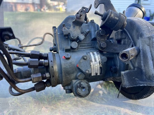

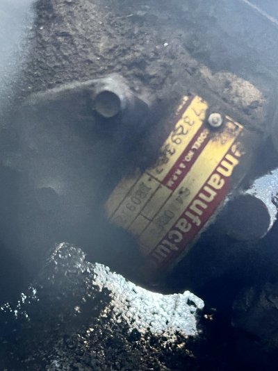

In the mean time I found that there’s a reman pump on the truck.
I found what looks like an original stanadyne db2-4821 pump in a pile of parts. Maybe I’ll get lucky by having a working stanadyne pump instead of these reman units that are prone to early failure
If it turns out the current reman pump that’s on the truck is bad, I think I’d like to try one of these $50 DB2 pump rebuild kits and rebuild it.

Do all of the injector pumps come with badging that read “REMANUFACTURED”? Or do the pumps that come from the “Big 4” (Russ, Wes, Justin from R&D, etc) ship IP’s with their own custom badge plate?
