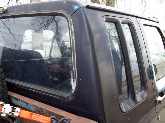

I may be completely wrong here, but after doing some more thinking, I believe that the Red Truck has the correct paint on the roof. In this picture, you can see where the white paint is showing through the blue paint on the back of the roof of the Blue Truck.

Roof and back of the cab should be the color opposite the hood. In the case of these trucks, the dark blue and the red. Ours was dark brown. I think the red truck is fading, why the color looks incorrect. But the correct Victoria, the hood color should stop at that top of the doors. The contrasting color should be on the roof, back of cab and the inside of the bed and everything on the outside except the rockers....
This was what ours looked like
Here is a snip from the Ford Truck Sales Brochure. It is opposite of Bronco's Red Truck. This shows the accent color as red, and the main color as white. His is accent of white and main color as red. My guess is, the truck is painted the main color, then the accent was laid over the top of it.... but this is just a guess.....
So his Red Truck should have a Red Roof, and the Blue Truck should have a Dark Blue roof....

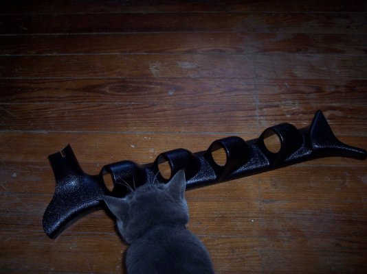

It came in today and it's not even Saturday. Not the cat. He's been here for over 5 years. The future home of the afore mentioned four gauges.

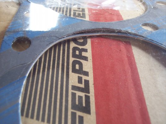

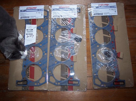

I did a little more parts buying. Rock Auto had Fel-Pro head gaskets on clearance for about $25 each. Since it doesn't hurt anything to have an extra set laying around, I tried to order four, but all they had was three so I bought all three. I got them in today, but one had a slight issue. They claim that they don't have any more in stock so a refund is heading my way. If they don't ask for it back, I will still keep it since it will still work to check valve clearances for my Typ4 cam.
