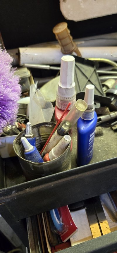

If you're using locktite you should be fine,
IF you're really worried get a small set screw ( allen head) and tap the interphase of the threads and locktite it in there, it's a forever fix you can pull apart.
My stash of various grades.
But don't go insane, get blue and purple ( removable) and red ( needs a torch to break free) and clean and dry surfaces, go along with a happy feeling of "that ain't going anywhere "!

I used the orange Loc-Tite since I've never had it fail on me but it's still way easier to remove than the red stuff. It would've been nice to be ab;e to use the lock washer but I guess this is one of those "Better Living Through Chemicals" moments.
