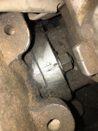

Saginaw pic: yep, the big o-ring goes bad. I had that same issue and it only got worse. You have to pull the whole stupid thing to change it but I must have done a good job since it no longer leaks on the RV.
