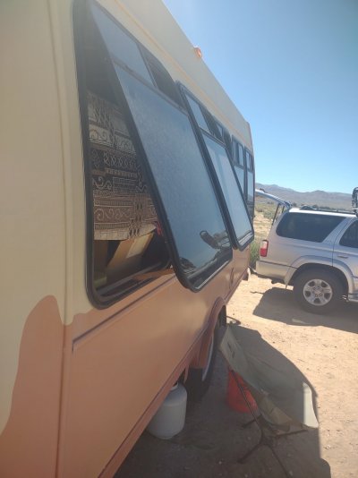

Maybe, I've been getting around 13mpg and it was running poorly due to air intrusion before the electric fuel pump. I'm interested to see what it does on the next distance run now that that is sorted.
At least that one has straight walls. Ours is a shallow curve, more "exciting" for doing a build out. And the glass of the windows is usually easily replaced w/ aluminum. Faster and easier than framing in the window hole for a wall section that you want to build against.
Also a lot of "emergency exit" windows are hinged.
